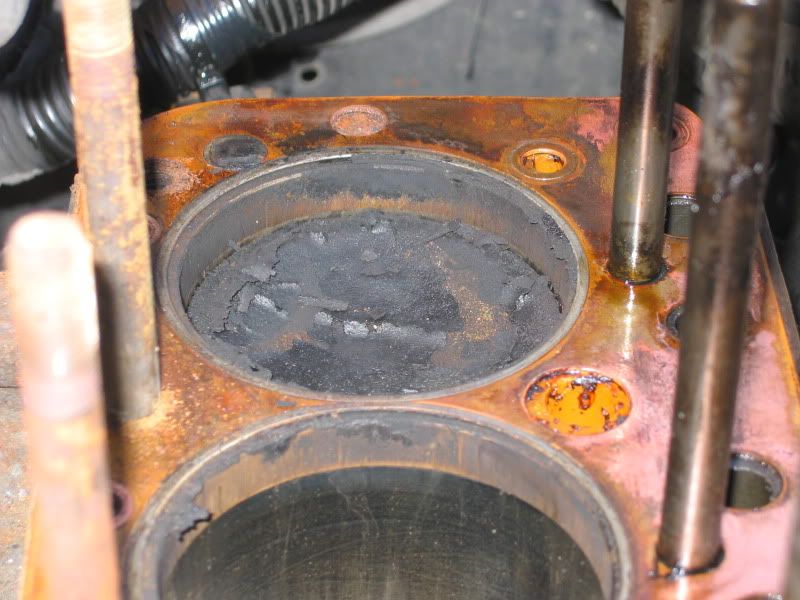

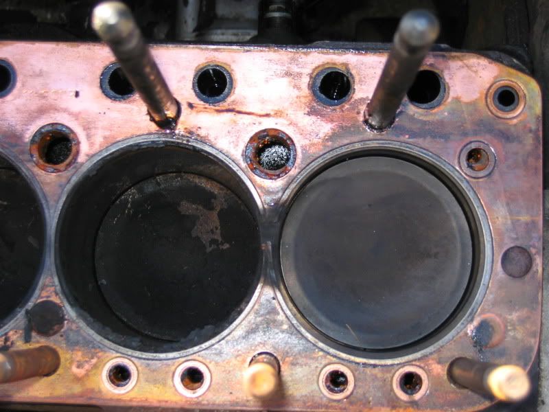

I changed the Head gasket on the Se7en today (2000 MPI). When I lifted the head off I saw a lot of carbonisation on Cylinders 4 , 3 and 2. Number 1 was perfect. Can anyone tell me what might have caused this?

That looks like the engine has massively over heated, this could lead to the gasket blowing where it is, the carbon deposit has been cause by poorly seating valves causing misfire and carbon,
have the valve seats re-cut in the head have the head skimmed to make it flat, change the head gasket for the BK450 and change the thermostat to a 80deg one all your problems should go away and the power will return,
I know a bit odd, but could this manifest itself in a cold engine? then go when warmed up adn everything has expaned?

Was the car smokey before the head gasket went ? that ammount of carbon could suggest rings . It would be wise to get a compression test done when you rebuild it .

I have swapped the head for another, this is temporary to get back on the road. In the meantime I have already planned to get my original head skimmed and cleaned up ( valves reseated ) . The overheating might have happened whilst my MPI expansion bottle developed a pinhole leak ( replacements weren't available at the time). I have a new Temperature sensor to fit.

Still in trouble , I did some test on the car the other day , low compression on cyl no 1 and a leak down test shows it leaking into the crankcase so it looks like rings.
Merlin says rings for these pistons are no longer available.
I've serched the net and I can't find a part number for these pistons, I have found sites claiming to have the right rings but I think they may be rings from an earlier engine ( ring no R41570).
Anybody help?

Have you spoken to an engineer about rings what is special about these rings ? Talk to a good piston supplier dont
get to hung up on part numbers. :? The head of the piston will be stamped std or 20 ,40 being standard bore or first
oversize and so on if you are useing the same bore you will need a set of ridge dodgers the top ring has a small step
in it to avoid the ware ridge

Lads I'm not going to Go into it as I just don't have the hours in my day to wright long winded post explaining why, you cant get standard size rings, etc, It quite complex and it suffices to say they cant be got other than a company in the states Total Seal who will supply you with a set of gap-less rings to suite the later type piston fitted to MPI for the grand price or £100 + vat + postages,
Why would people even thing of doing such a thing the reason there is bad leak down is because the bore is worn and the piston is most likely in the same state why would anyone even consider striping an engine completely to fit a set of rings to a worn bore and piston when for an extra few hundred quid you could have a freshly re bored engine running a nice set of +0.020" pistons and have piece of mind you have a new engine,

Yep that would be the way to go on this one ok! :D

It looks like rings but Kill did change the head for one he bought in good faith and didn't check it for any faults so if the head doesn't cheak out when removed we still may be looking at bores that are ok for new rings (80,000 mls). Kill says he didn't notice any scoring on the cylinders so it doesn't look like a broken ring, so is it common for one set of rings to ware so badly when the other 3 are showing very little leak down.
