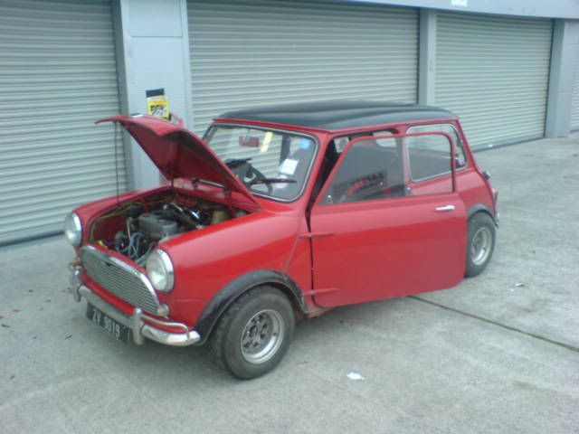

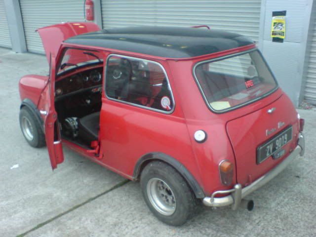

For those of you that havn't seen the car befour this is how it stands as of now

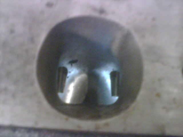

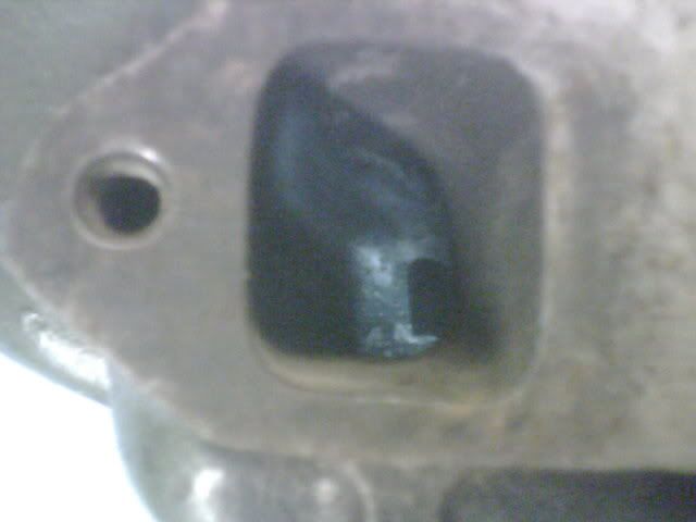

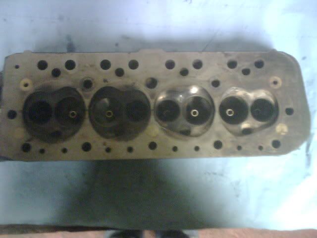

Steel EN40B 86mm stroke Crank on Standard bearing sizes in mint condition been wedged crossed drilled and bladed
A cylinder Head I have been working on for some months as you can see I have done huge port worked and I have also totally reshaped the combustion chambers
A nice set of MED 1.5 roller rocker, Paul Ivey 37.5mm inlets and 31.5 Exhaust's MED Piper Race valve springs.

mint!! its on the deck!! love the look of it! does it have spacers on the wheels??

PostPosted: Wed Nov 18, 2009 1:37 pm
the wheels are split rims 7 inches wide i think
