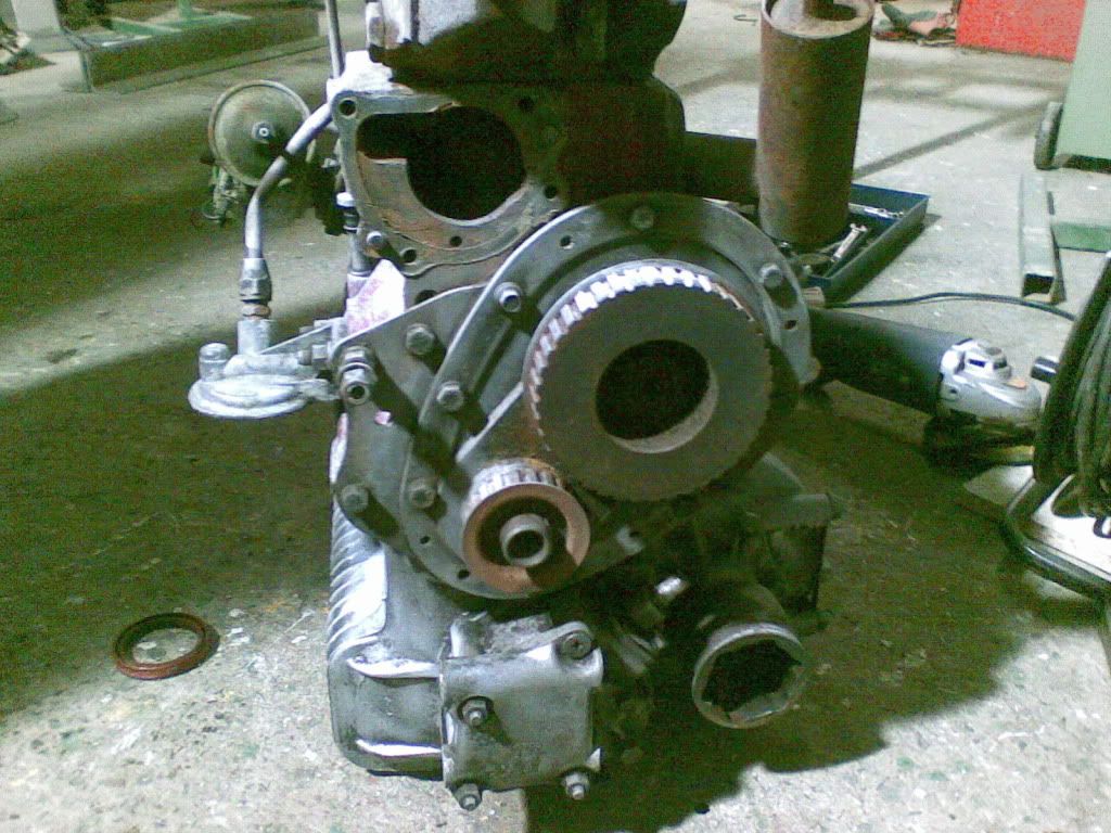

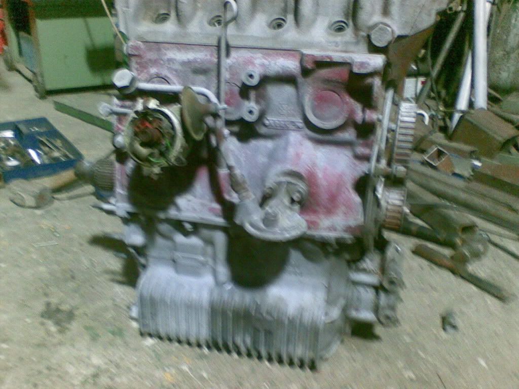

Engine Block Red in Colour with number #12 A 497J5073 on the back of the block, there is no engine plate on the front.
Furthermore the timing belt has snapped and a replacement is sought : Pirelli ISORAN 052 R 190 Trigger
Any help gratefully appreciated

tommy it looks like a metro engine with a timing belt kit fitted
have a look at this

looks like an A series engine too,
it doesn't have the webbing on the front of the block like the A+ units

It's definitly an A-series

That Is the Block casting number for a Small bore A engine If the Head has a casting number 12G295 then you have ider a 997 or 998 cooper engine if the head is 12A----- then you have a standard 998 or 1100 A series engine.
If I was you I would chuck the Cam belt kit and fit a standard timing chain setup it will serve you better those belt kits always end up leaking oil.

Does the # 12 not mean its a 1275 ????
PostPosted: Thu Jan 07, 2010 10:08 pm
Offline
all 1275's have 2 frost plugs just above the clutch housing, where the top engine steady bolts on. whereas smaller bores only have 1
